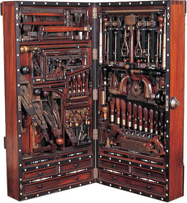

The Studley toolchest is awesome! I have seen several attempts at recreating it and the makers were proud to get 75 tools inside of them. The Studley holds over 300 tools and weighs around 300 pounds!
I posted a picture of it in the workshop for inspiration.

One final thought. If you have the time to build a beautiful and functional bench, it will be a tribute to your craftsmanship to anyone who sees it. That may be worth something. Have you ever seen the Studley tool chest? He was a piano maker who built himself an incredible tool chest --- remarkable enough that it spent quite a bit of time on display at the Smithsonian. I was once watching Norm in a tool-chest episode, and he was showing the Studley tool chest. Norm commented "if he built that kind of tool chest, imagine what kind of pianos he made." There's something to be said for that.
He must have been one heck of a craftsman.
With that said, he probably did it in his downtime, and did not take time away from paying jobs to work on his tool chest.[/QUOTE]
It's my understanding that the tool chest was his "masterwork" completed before his apprenticeship was over. Regardless, what a marvel of thought and engineering! I have stared at the photo in Fine Woodworking time and time again and always see something new. Wow! Can you even conceive of doing that today? Hmmm... do I include the 18 volt drill or do I hold out until I get the 24 volt drill?

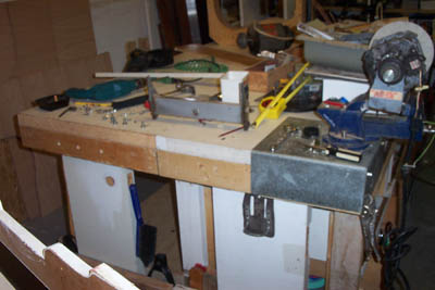

PostPosted: Sat Feb 18, 2006 10:46 am
what workbench? Oh you mean that thing under the clutter I stand in
front of all day...
I am building myself a new one though this coming week. It is going to
be rather primitive with 2x6, 4x4, MDF, plywood and hardbaord. It won't
be as cool as the green bench!
